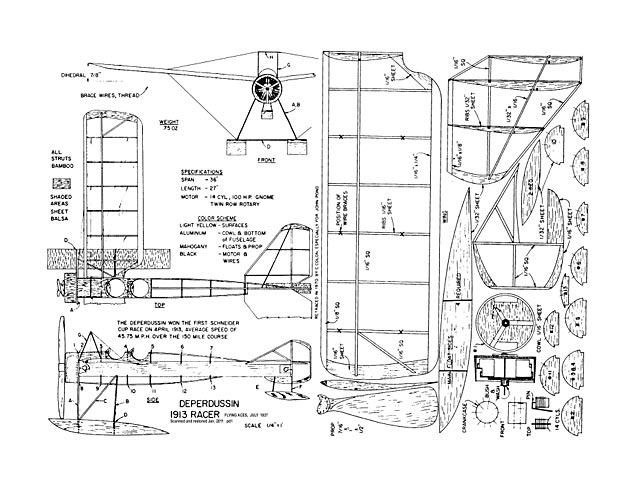

Typ na jednoduchou a létavou minimaketu - old-timera vhodného i pro FLY OFF . Model postavíte za dva večery, chce to jen jinou barvu modelspanu, celý letoun modrý!
Deperdussin 1913 Racer
from Flying Aces 1937
18in span
Tags: Scale Rubber F/F Floatplane Civil
all formers complete
This plan was found online 23/04/2011 at:
http://www.rcgroups.com/forums/showthrea...
A backup copy has been saved as:
PlanID: 693 | Filesize: 482KB
Credit*: pd1
Format: •PDFbitmap
For available downloads of this plan held on the Outerzone server, see the download page
Deperdussin 1913 Racer - completed model photomore pics (3)
Plan file details:
Deperdussin 1913 Racer - scale model of the winner of the original Schneider cup trophy, with an average speed of just over 45mph. From Flying Aces 1937.
Corrections: Did I get something wrong with this plan? That happens a lot. Help me make a correction

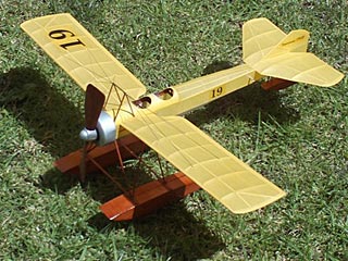

Hi Steve!, I'm Marco A. Guillermo from Mexico, I have finished my Deperdussin racer 1913, here you have some pictures, when we fly it, I'll send you other pictures.
MarcoAGuillermo - 15/02/2013
